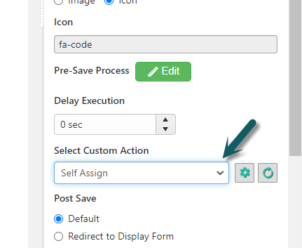

Quote from supportTeam on August 29, 2022, 4:14 pmDefault save button in the NITRO form will not invoke any custom action. We need to use a submit button (reference: https://help.crowcanyon.com/article/362/#Index1) and choose the custom action in its settings as shown below. By using this submit button, item will be saved and then custom action execution will process immediately after it is created. In this case, we do not need to delay the process, so we can remove any script that is used in post save settings that is configured to wait.
