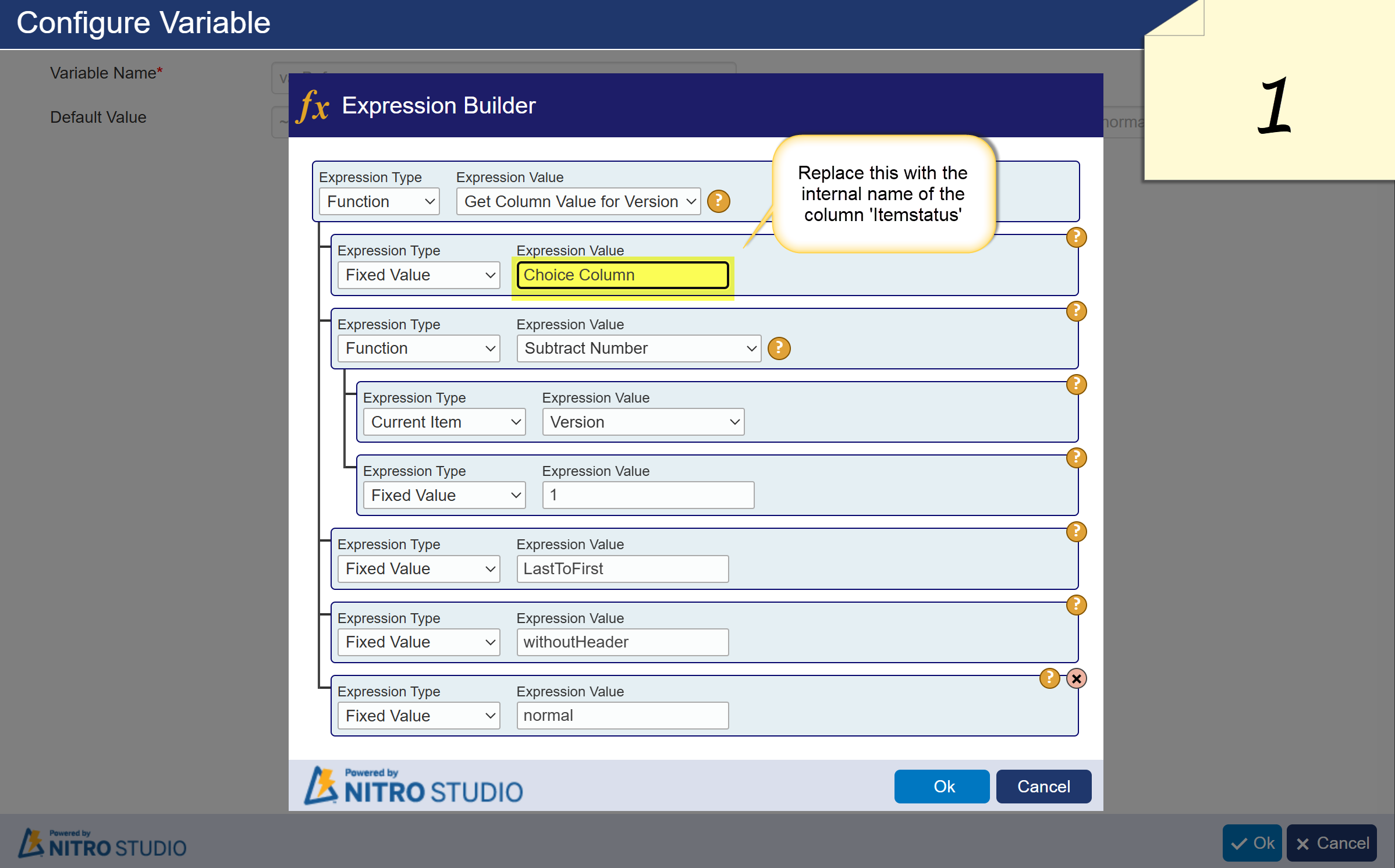

- Click on hamburger icon beside ‘Default value’ to open the expression builder and configure it as shown in image 1

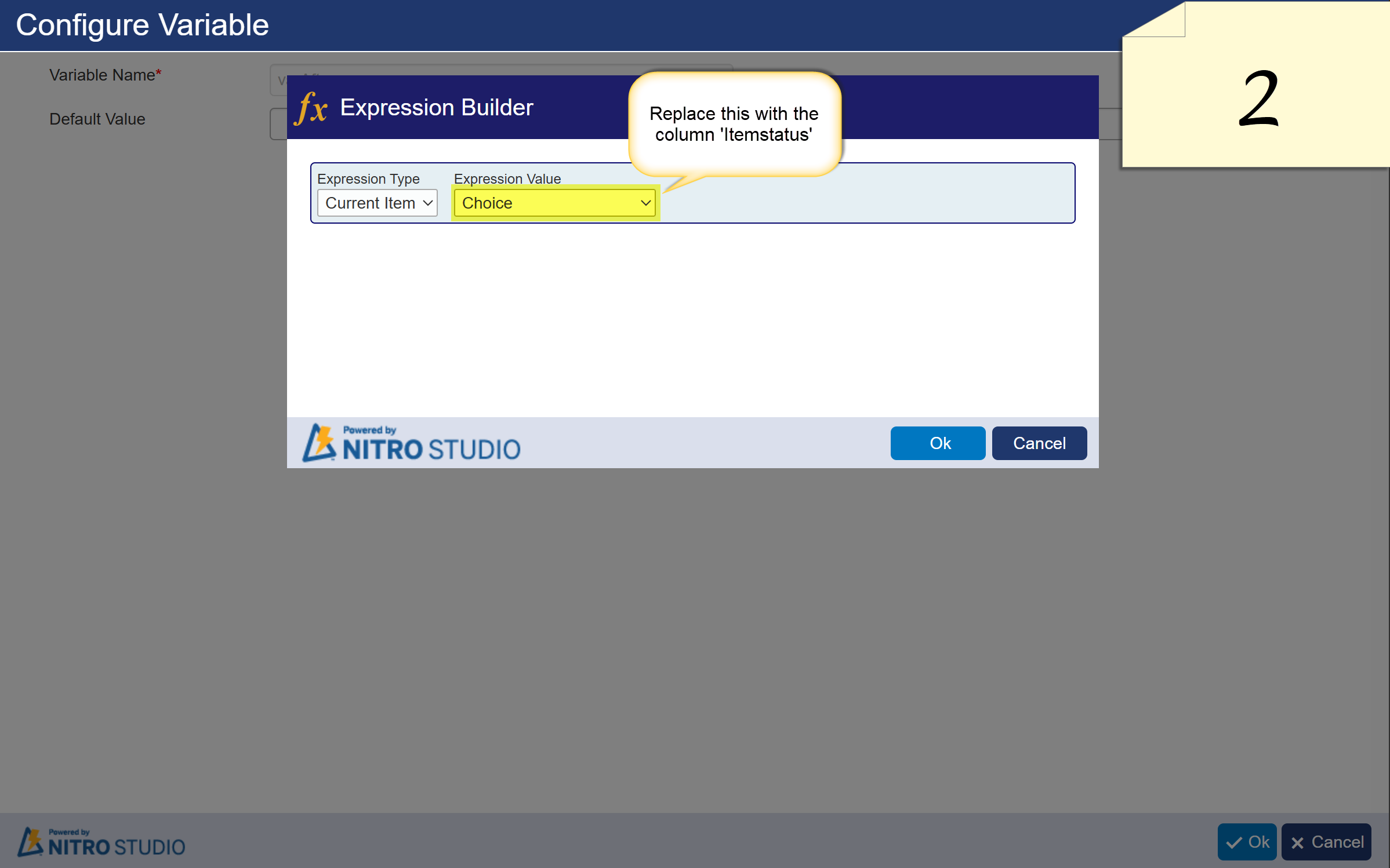

- Click on hamburger icon beside ‘Default value’ to open the expression builder and configure it as shown in image 2

To capture the before value in a variable:
- Open the workflow
- Click on ‘variables’ on the top → Click on ‘New variable’ → name it as ‘varBefore’

To capture the after value in a variable:
- Open the workflow
- Click on ‘variables’ on the top → Click on ‘New variable’ → name it as ‘varAfter’
