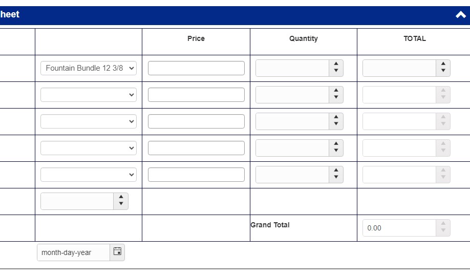

Quote from anguyen on September 26, 2023, 3:47 pmHello,
I have a lookup column from another list, that I would like to auto fill once another column is triggered.
My current setup right now is that the lookup column is a drop-down and i would have to manual click the lookup column for the item to appear. How can I do that?
I also tried having the lookup as a single line column instead, but it's giving me a blank area.
I've attached an image of what I'm working on.
The left column are my entry, the 2nd column(PRICE), is what I want to auto-fill and lookup.
Hello,

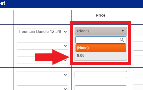

Quote from anguyen on September 29, 2023, 5:53 pmHello,
Thank you for the assist! I did manage to get the lookup column to work. As for the auto-fill, the column that I want to auto-fill is not part of user information, but it is the item lookup. I'm kind of stuck at that point. How would auto-fill and item column after another item is selected?
I've attached an image of what I'm trying to auto-fill after it was selected.
Hello,
Uploaded files:Quote from anguyen on October 18, 2023, 1:38 pmfinally was able to get it popped up! But on another project. For this one, what I did was that the "price" columns where single Number columns. for the 'fountain bundle' lookup column, I was able to update it with 'auto-fill' function when editing the column.
