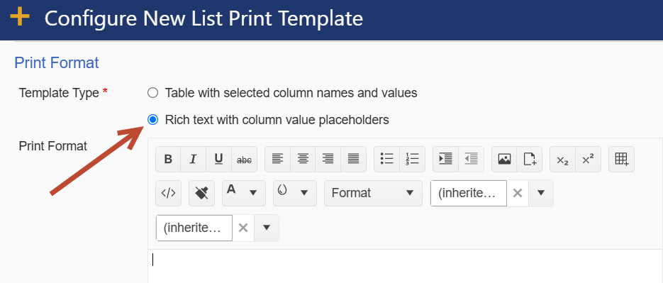

Quote from supportTeam on March 20, 2025, 8:28 amHi Art,
Currently 'NITRO Form' print template is not supported in item print, You can use 'List print' to print multiple items at once with the template type as 'Rich text with column value placeholders' and add the fields in it. You can refer to this article https://help.crowcanyon.com/article/378/ for more details.
