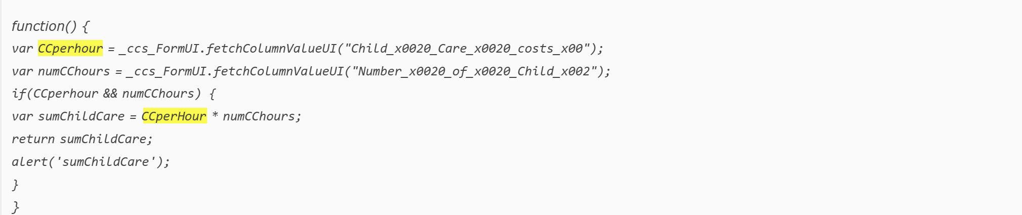

Quote from Jay on January 20, 2025, 5:04 pmI'm still missing something here I got the field to update by using column value mapping and then selecting value (instead of script) and then updating a column with the product() of 2 other columns. This worked fine except that it would always update the column with the value of the first amount before the second had been provided. For example of the user typed 50 into ColumnA then ColumnC would show 50 even though the user had not entered a value into columnB. It was the NULL value in columnB was being treated as a 1.
So, as I have a few calcs to do on this form I thought I do it all in one script as if(ColumnA && ColumnB) sounded like it would solve the issue mentioned above.
However I can't get the "script" version of "column value mapping to work at all. I can't even get it to alert() me the return value and I get no errors in the dev tools console.I need (in the first instance) to be able the column called TotalChildCareAmount once I get that working I'll need to do likewise for another couple of fields - and then finally a grand total.
If I can get the first one working I should be good from there. I have checked and doubled checked the column internal names are correct.
It is set to execute on column value change and be applied in the new and edit formsfunction() {var CCperhour = _ccs_FormUI.fetchColumnValueUI("Child_x0020_Care_x0020_costs_x00");var numCChours = _ccs_FormUI.fetchColumnValueUI("Number_x0020_of_x0020_Child_x002");if(CCperhour && numCChours) {var sumChildCare = CCperHour * numCChours;return sumChildCare;alert('sumChildCare');}}

Quote from supportTeam on January 21, 2025, 8:22 amPlease make sure the variable CCperhour is consistent in the script(Please check the attachment). You can use the script below and let us know if it works for you.
var sumChildCare = CCperhour * numCChours;
alert(sumChildCare);
return sumChildCare;}
